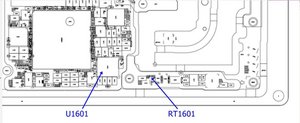

@jurajstefanek you've got a lot going on here with your phone. What concerns me is the issue with the new battery. There is no reason that the new one does not work, while the old one does. I would just once more get a new battery. Just in case there are issues with your recent purchased one. The temp low can actually originate from the battery sensor. The other issue can be a failed component in the Charge Temp circuitry. You may want to check RT1601. Also, U1601 is the PMIC for the charging etc. (not the low temperature).You could try a quick reflow and see if that makes a difference.
Let us know what voltage you show on your battery connector when the charger is connected and when it is disconnected.

@jurajstefanek " 1V-1,5V, then slowly decrease to 0V. Then after a while jumps again 1V-1,5V and so on." that voltage is way to low. It is below the threshold for your phone to even come on. You did measure that on the DC scale? where did you measure that? Post pictures of where you measured the voltage.
Reflow can sometimes be done by just applying heat. IT is not a reball. If you have never done anything like that, this may not be the best project to start practising :-
