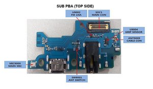

Voice is not listen?

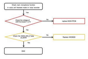

Mic is not working. Outgoing voice is not listen by reception
@ummeechauhan it is possible that this is a bad mic. It is solder on the charging board.
Use something like this video to work on your phone.
The M30s comes in different variations. SM-M307FN/DS (Global); SM-M307F/DS (India) make sure you get the right part for your specific model.
