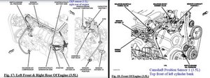

I can't find the camshaft sensor or the crankshaft position sensor on my 2010 dodge avenger 3.5l v6. Haven't been able to find videos on this specific one either.
Hi @chaserunyan
Here's a composite image from the 3.5L engine section of the 2008-2010 Dodge Avenger repair manual, showing the location of the sensors.
(click on image)

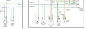

Hi @chaserunyan
Maybe check the wiring from the sensor back to the power train control module (PCM), especially the blue/grey wire
Here's the wiring diagram
(click on image)
I switched out both sensors and my car is still popping codes for the camshaft sensor not really sure where to go from here. Like what to check next.
