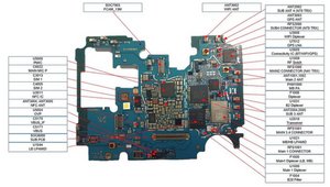

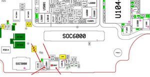

After that, you want to check according to the flowchart
and here is where you will find the components to be checked.
