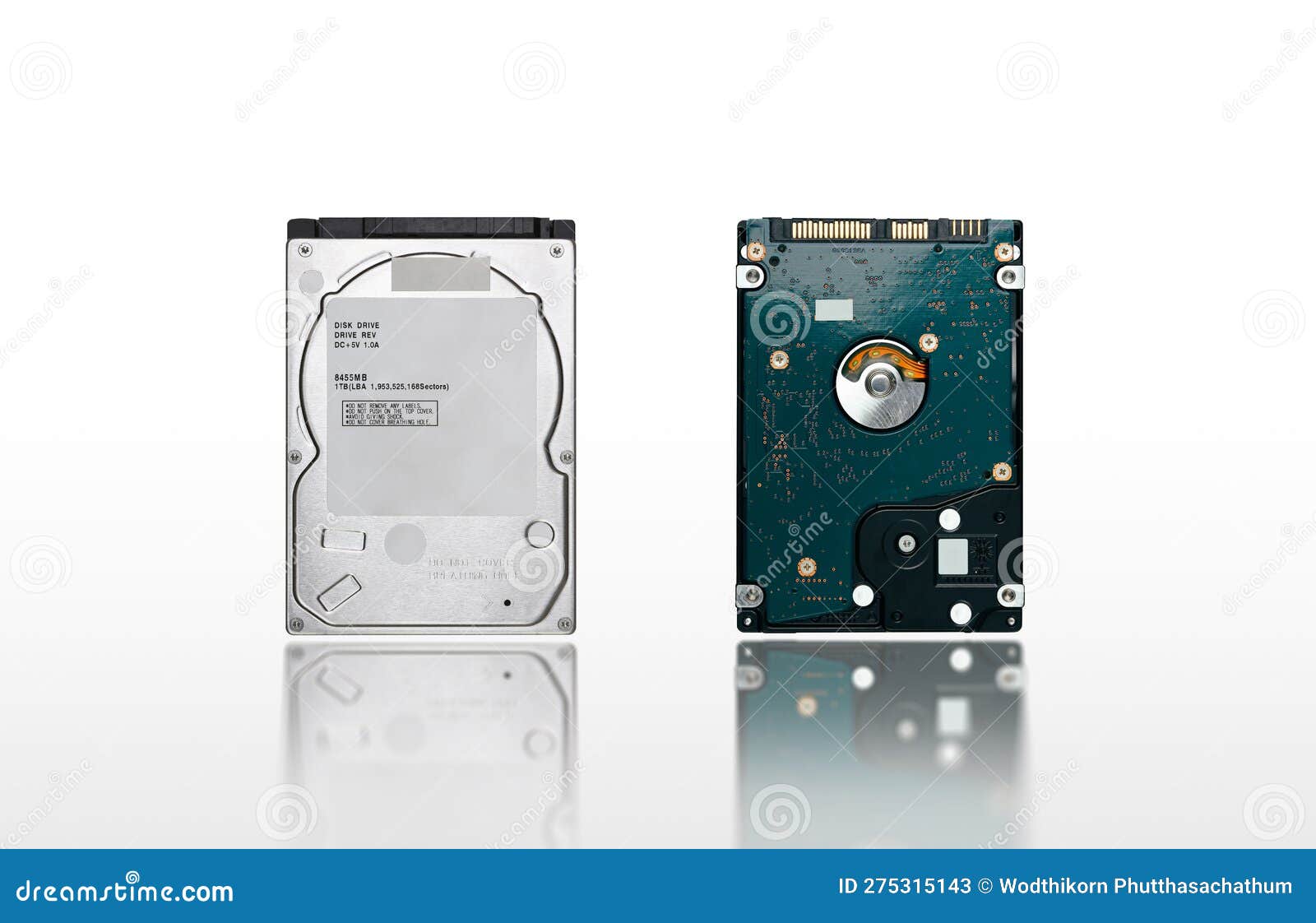

Why is my laptop bringing boot device not found when I on it
Your "boot device" is your hard drive.
This device shipped in 2015 with a HDD. HDDs for the consumer market (i.e. what would be found in your laptop) typically have a usable lifespan of 5-10 years. If yours is still on the original HDD, it is most likely an EOL failure.
The best solution would be to backup/clone your data, if at all possible, and replace the HDD with an SSD. I recommend Macrium Reflect free version (https://www.macrium.com/reflectfree) to do your backup and cloning, as it is easy to use, and their forums have experts on their software to help if you run into any issues.
This would involve physically opening the bottom of your laptop, locating the HDD (looks like this: https://thumbs.dreamstime.com/z/front-ba..., though the label can be any manufacturer), and remove it.
