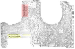

Can you install any A1286 logic board in 15" Unibody?
I have an Early 2011 MacBook Pro 15 Unibody with a Core i7 2.0 Ghz that recently had water spilled on. Now the Apple Logo comes up but the screen goes black after the system loads. Apple told me it need a new logic board (not under warranty if there is caused by spillage). Being that logic boards are expensive I found a mid 2010 Core i5 Logic Board that is relatively cheap. Can I install it on my Early 2011 A1286 MacBook Pro and have it work?

I had success now replacing my A1286 15", 2.4Ghz i5 with a 2.66Ghz i7. All the parts fit fine. But like mentioned here there is a difference from 2010 to 2011. The lowercase is the same but the let speaker and the plastic bracket with the cables (bluetooth,airport etc.) are different. Still I had no problem getting the 2011 Quad-Core i7 logic board to fit and start up in my original 2.4ghz, i5, 2010.
crwdns2889612:0crwdne2889612:0 12
+ Did the motherboard mount to the upper case in a slightly different position in the 2010 & 2011 so that everything so that the differences in left speaker, airpor, etc... did not matter? Which battery did you have to use for this, the 2010 or 2011? Thank you.
The bluetooth/airport housing on the 2010 model has 3 cable contacts + camera cable (http://guide-images.ifixit.net/igi/UoJNE...) whereas 2011 model has 4 cable contacts + camera cable (http://guide-images.ifixit.net/igi/yILuc...).
The physical size of the housing is the same and the screw holes fit so I guess the 2011 has a different cable setup from the screen. You would have to move over the old housing I guess. The camera cable from 2011 may be too short to fit the contact on 2010 board since the camera cable contact on 2011 is closer to the fan.
The battery, (A1321 in 2010 and A1382 in 2011) , (they increased it from 73wh to 77.5wh from 2010) seems almost the same but 2011 has the contact on top of the board while the 2011 connects from the side. The battery is listed as two different parts for 2010 and 2011 and I think that is because of the cable connector. You can change the cable from the battery to the board but do not buy 62wh or 73wh. I always buy original Apple battery.
So I guess I answered the question to myself that this may not really work well. From my investigation there is not much a price increase from the a 2010 logic board to a 2011 if you look around and I would stick with 2011 logic to make sure everything fits. My conclusion is you can exchange any logic board from the same year (2010, 2011). Sorry if I am confusing here!

So after a long time waiting, I actually ordered two separate logic boards and they both finally came on the same day.
Issues
A minor issue popped up when I was re-applying the heat sinks on the USB controller and the platform controller hub (assuming the heat sinks are necessary on the 2012s). It could have been the supplier I chose or possibly these models don't heat up as much, but the new board didn’t have screw holders like the old one did.
Either way, I came up with a solution. I cannibal-ised my old system, popping off the screw-holders used on the old circuit board and super-gluing them to the new one in the same position. Turns out super glue is non-conductive so it was perfect solution to hold down them down so I could apply some thermal paste.
The rest of the ports, cables and screw holes lined up perfectly. Even the cables to the fan that I had broken (I pulled instead of lifted). Needless to say, I was very happy with my current array of upgrades: 2.3 GHz > 2.6 GHz, USB 2 > 3, bluetooth 2.1 > 4, Radeon 6750M > GeForce 650M, RAM: 16GB and the HDD(s) [1TB Hybrid in the SuperDrive bay and a 120GB SSD in the main bay].
So YES, it is totally possible to interchange the unibody logic boards (at least early 2011 to later 2011 or 2012) if you are so inclined. I don't think anything in my system (aside from the magsafe adapter, battery, speaker, and display) is the same as when I first purchased it. Mine was a 15in display, but I don’t see why this process couldn’t work with a 13in (you can never research too much).

820-2915 2011 is what you have. This is 2011. This board is ok besides the GPU. It will fail every 2 to 3 years, and only get worse as time goes on. The boards available have already been used for 2-3 years, and the replacement chips are harder to find new, so more people will be advertising "repairs" for this board that don't actually work more than 2 months, because they are not using new chips. This board is bad.
820-2850 2010 will fit, but only if you get the older battery. You can just chop up the connector and splice the wires from your battery onto the connector of an older battery, but this is a pain in the @%^. 820-2850 also have rampant kernel panics due to issues with VRAM pgood signals and other that is too much to mention here. Short story before dan calls my sentence noise, 820-2850 is junk to be avoided at all costs. This board is WORSE!
820-3330 2012 will fit but require you mess with the LVDS cable to get it into the connector, which is slightly different. This board is much better. You get a cooler running processor, a cooler running, MUCH MORE durable GPU that will NEVER die on its own, and no stupid random issues. This is also an upgrade in processing power, GPU power, and battery life because this is a more efficient processor. Your present battery will fit this just fine. You may have to replace the LVDS cable for it to fit if you can't jimmy it in there. 99% certain this will have to be replaced.
Any other boards like 820-2330, 820-2523, 820-2532, will not physically fit the machine. Also, these boards do not use the same connectors for wifi, bluetooth, webcam, hard drive, etc - it will all be a mess and not fit at all.
These are the ONLY differences in terms of how it connects and fits into your machine. Make your choice wisely!

Yesterday I swapped MBP early 2011 logic board to mid 2012 2.3 Ghz board. I had the same problem with LVDS cable as casagrande2407 mentioned. 2012 board was already with heatsink preinstalled (the seller told that it is a brand new logic board ). I watched several videos on MBP 2012 teardown and noticed that there is no heatsinks on Platform Controller Hub and Thunderbolt port controller, so I decided not to install heatsinks from dead board. While I'm writing this the hottest part of the board is CPU and its temp. differs from 33 C to 40 C.

Thanks a lot Brad for the very useful info. I had the same early 2011 logic board that suffered from the well known GPU problem. Based on your postings I decided to replace it with a mid 2012 2.6 GHz logic board. The whole operation took me about 2 hours. The most difficult part for me was to connect the LVDS cable, the connector on the mid 2012 board seems a bit smaller.
The board that I received was just the board with all the chips on it but no provisions for cooling of the chips. It was quite easy to transfer the heat pipe of the old board, but nothing was foreseen to cool the Thunderbolt controller and the Intel BD82HM65 Platform Controller Hub (I looked that one up ;-), also no screw holes present. I took both the covers from the old board and 'glued' them on the cooling past on both controller chips. Of course this is a very imperfect temporary solution which is holding now for a week. I'm not sure what the final solution looks like for this. The screw holes mounted on the old board can only be taken off by using a lot of violence - I'm not sure if I will succeed without ruining them. But further I see no room on the mid 2012 board to put the screw holes as there are electronic components scattered around at the spots where the screw holes should be positioned. Even with non-conductive superglue I doubt it is a good idea to fit them on the new board. So I am very curious Brad how you managed to do that!
Either way I am very happy with my 'new' MBP.

Going backward in years will be challenge, 2 or 3 connectors are moved an inch or two on the motherboard making the cables a little short. I replaced a Mid 2010 MBP 15 logic board with a Mid 2012 board. Those connectors moved to give me a little slack in the cables. The video cable had a fitment issue and i was hesitant to take file to the outside edges of the male end, but I filed a little plastic of each side of the connector and it fit perfectly, but the latch would not latch completely. (it fits snugly enough for this not to be a problem). The other challenge was the battery. I had to snip the the outside 6 wires on the connector, then splice them on the opposing sides. The outside wires are 3 + on one side and 3- on the other, and the must be switched while not moving the center 3 wires. after this mod, I had to clear the memory (SHIFT, CTRL, OPT, PWR) and reboot the get the computer to pick up the battery as normal. Now I have the perks of airplay, I went from an i5 processor to i7 and other upgrades.
great, good to know! Any idea where to get those logicboards? And any idea on whether I can put a retina display into my early-2011 MBP on core i5?
Sorry, you can not put a retina display in a early 2011 MBP. It will not fit, the cable will not fit and I doubt the logic board has support for it. When they release a model you switch parts within the same model e.g. the 2010 MBP 15" can use a i7 2.6Ghz logic board in a 2010 MBP i5 2.4Ghz.
