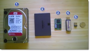

Replacing the drive requires physically opening up your computer, locating your drive (it is likely a 3.5" drive, #1 pictured). If you need to replace it, I would recommend at least getting a decent SSD (2.5" drive, #2 pictured). You will receive significant performance improvements and you can get a decent one for only about $40 USD.
Changing drives is as easy as unplugging the two cables that are plugged in, releasing any screws that are securing the drive in place, and physically removing it from the case before putting the new drive in and plugging it in. A 2.5" drive will not fit all the screws that the 3.5" drive did, but they are so much lighter weight that just one or two screws, or even a strong piece of tape, is enough to secure it down.

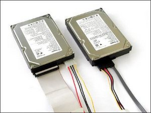

Most likely your drive is a SATA drive (right pictured). There may be IDE drives (left pictured) in use in cheaper builds from 2007. If you have an IDE drive, a replacement is not as simple so please come back for further assistance before doing anything.
