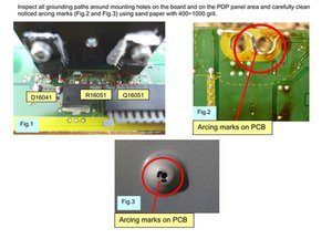

@burtben what the heck. Why would the SS1 go up in smoke again.? We need to find out what could be shortening this out. Some Panasonic's had issues with the board shorting out to the chassis on the screw holes. Anything obvious that you may have noticed on those areas?
@burtben see if your TV has any of these issues. Hard to see at times so it requires some careful inspection.
we may just have to find a service kit for your board and see if we can fix yours. see if you can find this where you are. If not I can send it to you. SS Board Repair Kit TNPA5623 TXNSS1SDUU
Post a close up of your board. Let's see if we can find the root cause
You okay with soldering? Standard stuff. Nothing that requires a microscope but possibly some magnifying visor if you are old as me :-)
