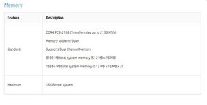

There is no removable memory in the laptop. It has either 8GB or 16GB of memory hard mounted on the motherboard.
Here are the memory specifications as shown in the product specifications for the laptop.
(click on image)
