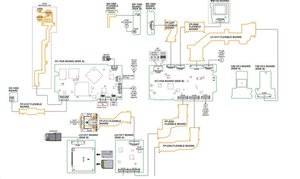

How to change card slot sony fdr ax 33
Memory Card slod is broken
@aghyadalmobaid not sure how it is broken but you can replace the board where it is mounted on. The board is the LD-1017 board and Sony part number is A-2072-059-A
To get to it, you can use these guides Sony Handycam FDR-AX33 as well as the disassembly part form the manual Sony FDR AX33 Disassembly For a partial teardown check this video. None of that is easy and requires a lot of patience and organization.
