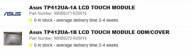

Here are some images showing the Asus part numbers for the TP412UA and TP412FA models, LCD displays.
Search online using the appropriate part number only for your particular model to find suppliers. That will give you an idea of the price of the replacement part. After that you have to factor in the labour cost unless you do it yourself.
Usually the part number can be found somewhere on the back of the display (if accessible) if you wish to verify the number.
