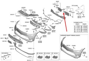

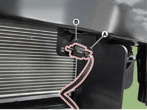

Where do I mount the ambient air temperature sensor, on the front bumper or radiator?
@leetruckergirl here is the location for that sensor.
Here is the same by part number which in your cars case is 96985
