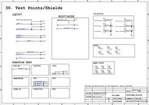

If you need to do a board level repair, use something like the test points to see if you have power
Now use the search function of your PDF reader to find the test point on the board in this document Honor 8X (HL1JSNM) PCB Layout Do this only after you have changed your charging board and your battery. Do not get ahead of yourself.
After that, re-evaluate your phone and see if it now comes on. If not you may need to dig deeper into the board level of your main board.we will have to gig deeper into
