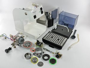

I am now tasked with repairing a Starbuck Barista (or Saeco SIN006, same parts different colors). The owner had it for the past 20-something years, and, not knowing anything about espresso machines, had the pump replaced about 2011. I recently thought it would be a good idea to clean the somewhat clogged up portafilter, so I used the appropriate cleaner (caution: this is not a descaler) as I didn't want to use vinegar or CLR and its everlasting smell. So the good news is the portafilter and shower screen are now completely clean. The bad news is the issue I was trying to get rid of didn't go away.

  • Dismantling the pump, just because. Here are some pictures:
Inlet plastic tube is reasonably clean. Rust marks are actually on the outside. Plunger is a bit loose in the tube.
Plunger O-ring isn't as tight as video tutorials on ULKA pump show it to be, but snug enough it doesn't slide off by itself.
Plunger plastic ball appears to sit properly on the thin end of the plunger.
High pressure side has a bit of scale build-up, but nothing out of the ordinary

Perhaps you should have a look inside the heater. The teardown shows how to do this. I had a similar issue on a Saeco SIN17, this guide helped.

An update: I'll first try a descaling as I'm pretty sure the last one was 8 years ago.
I had a look at the teardown guide, but the steam valve knob wouldn't budge. I'll try again.
On the picture, my machine doesn't have the parts circled in green and yellow (not sure what the green one does)
On another half-boiler from a SIN017 I had previously, I tried to un-screw the mushroom valve holder (red), to no avail. No matter how hard I tried, being with screwdriver, washer or provided tool, il wouldn't rotate. Hopefully removing it won't be necessary.
Part circled in green is necessary when using the single basket, according to Stefano's Espresso Care. So, not absolutely necessary.
Try a shot of CRC "FOOD SAFE" penetrating oil on the outside of the valve holder. It will seep down to the bottom of the threads. Then let it sit for a few hours/days.
The penetrant isn't magic, I still had to use a fair bit of force to break the valve free. But I was able to break it free.
CAUTION, be careful. Do NOT round off the notch on the valve, or you will have to grind the notch straight vertical again.
Water leaking from the top of the PF indicates a gasket leak from one of two places.
#1. The head gasket.
First CLEAN the gasket and top of the PF of any coffee grounds, then try again.
If it still leaks, you have to replace the gasket.
#2, The red gasket inside the PF has torn, and is not sealing against the basket.
This requires rebuilding the PF.
