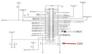

SMD Component fell of. What is it
The SMD-Component marked in Blue fell of my Motherboard. Does anyone know what it is (and where to order it). Might it be the cause of my black screen (Touch is working, however you can only see black?
looks like a capacitor which wouldn't cause that issue

The missing part is reference designator C503 which is Samsung part number 2203-005736 which is a 100PF, 5%, 25V, ceramic chip capacitor in a 0603 package.
Looks more like Audio than Video
@oldturkey03 i just went by the colour of the component, didnt look schematics lol
@tech_ni at least you were right. I am not as good as you guys by figuring things out just by looking at it. I still need my schematics for those repairs. Amateur :-) It even looks like the cap just connects to ground so it most likely could remain missing :-)
@oldturkey03 if there is plenty of caps on the rail it will still function fine, just the chances are if the rail fails again it will be a different cap
