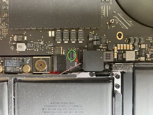

Hey there,
Unfortunately, I ripped the tiny battery connector from the logic board, while trying to take out the battery (picture attached). Is there any way to repair that or do I need to replace the logic board?
Update (06/19/23)
Here’s another picture attached. The object (plug?) in the green circle would needed to be placed where the red arrow is pointing to. While trying to take off the cable i ripped it of the logic board.

Some people break the connector often snapping out the ZIF connectors compression latch so you either need to find it on one's desk or floor to put it back or you need to buy a replacement connector to snap it out and snap it into your boards connector.
Some destroy the connector in the process of getting the ribbon out not realizing this is a ZIF connector needing a full replacement of the connector.
Then some damage the cable over bending it or mangle the contact area so when the ribbon is inserted into the connector it doesn't offer a good contact when the compression latch presses it into the connectors contacts requiring a new cable.
Then the act of prying the connector damages the PCB by lifting the connector off the PCB you either have all the solder pads still present or one or two are ripped off and you need to patch the damaged line.
Looks like one solder pad is already missing, thats means you must find in schematic where this line is going and can route a patch line to reconnect it.
When you share the exact motherboard number i can look to schematics.

@vojtech59738 maybe with a closer, clearer picture the trace for the pad may be visible.
It's an A1990 model. I will add another picture
@nigel yes when is on the 1st Layer, but this MacBook have 7layers PCB.
@vojtech59738 on the second picture you can see the trace going to the ripped pad. Doesn’t look like a hard job to fit it. Looking at it you could probably expose part of the trace and run solder from the connector pin to the trace. I did it once with a vape circuit board. Trace was that close to the pin there was no point running a wire.
it can be repaired but it would need someone with good soldering experience to repair it

@fen18106 if your in germany ben or some of the techs at resq would be able to repair it. https://www.resq-repair.com/en. if any of them pads are damaged then you would need the boardview to see where they go and run jumper wires
@tech_ni solder a jumper to R6952 :-) boardview verified :-))
@oldturkey03 820-00850 board im guessing
crwdns2934275:023crwdne2934275:0
@fen18106 let us know what board number you have on there. I show a 820-01041. That particular pad is SMBUS_3V3_BATT_SCL and could connect directly to R6952.
@strongbow the trace is visible but a PITA top solder too, I'd solder a jumper to the component :-)
I am really not sure if the pad is actually off or just needs to be cleaned. Must be my old eyes :-)
Re-tinning the pads would be a good start then check the path using an Ohm meter or continuity tester between.
Just be careful as you could make things worse.
The pad is definitely off - i had it right in my hands ;)
The board number is 820-01041 or 820-01326 - on the box of the MBP "Radeon Pro 560X" is written - and on logi.wiki there is "Radeon ... vega", so I am not 100% sure which one it is: https://logi.wiki/index.php/Board_Number...
@fen18106 like I said, maybe my old eyes. Always good to verify. So, the instructions are right and it's the right component to run a jumper to.

I soldered everything back on , and attached traces. But my macbook shows X over battery icon, even though it works on battery and charges properly
@brouty - Sounds like the repair wasn't complete or something went wrong or the connector it's self was now damaged and needs a replacement, or the MacBook Pro 15" Retina (Mid 2018-2019) Battery Daughter Board Cable is damaged.
