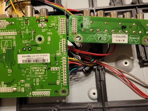

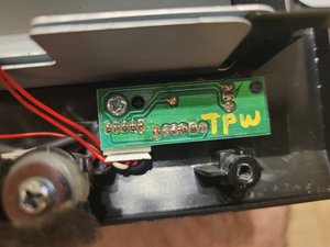

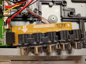

This is the IR sensor it has.
Here is the ir sensor board and connector
[image|3018206]
[image|3018205]
[image|3018204]
[image|3018207]

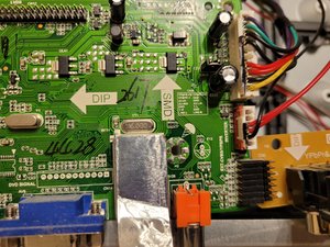

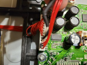

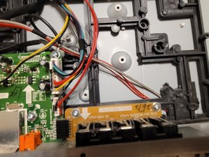

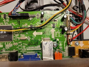

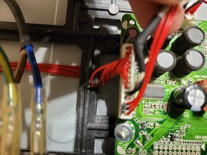

This is the ir sensor cable leading to the main board and where its connection to the main board. It has a black marking but i think its maker since more connection on the board has the same markings.

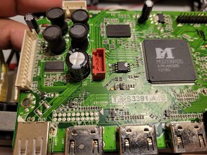

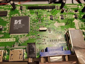

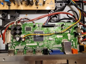

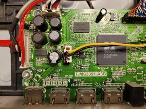

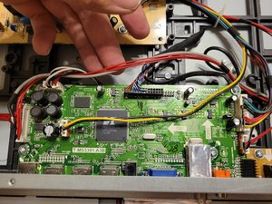

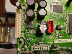

The main board

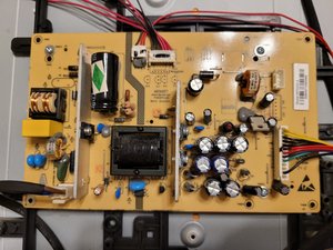

The power board

@jesusrodri90005 first off, yes, this sounds like it is the IR Sensor. Even so the images are not quite clear, the solder joints do not look right at all. It even appears (could just be the images) that there is a solder bridge between GRD and the 5V as well as some cracked solder joints.. Of course, you could solder the components, clean the board and solder pads and then solder the components since we do not know about the availability of spare parts for the TV. Give it a try and see if that fixed it.

I added an image to my answer. Check the component in area 1 Looks like a diode (the one with the three legs. 2 on one side and one on the opposite). See if you can make out the writing on it. Area 2 has some "fuzzy" area and may be it's just the image but double check that area if there is anything "odd"
I was able to find another IR sensor board cheap and replaced it, but the issue stayed the same. It wont turn on with the remote. When you turn it on with the tv power button is response well with the remote control.

@jesusrodri90005 I agree. This sounds like the part that is supposed to get the on signal from the IR board, does not get it. Can you follow the connector and see where it plugs into. See if there is anything "odd" looking"
@oldturkey03 Yes i posted the pictures as an answer because i could not figure out how to post pictures in a comment. I hope your able to see them
The ir sensor board and its connections
The ir sensor cable leading to the main board and its connectorm it has back marker markings andnthe bundle or red wired that are folded to the side leads to the board of the tv buttons
The main board
The power board

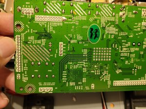

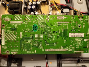

Here are some more pictures of the board and its underside
