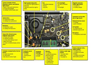

I suggest that you follow the Apple flowchart on how to test for the No Power Issues. After all, even an issue with the DC-In Board could be causing your symptoms. Check the Functional Overview and you see which part could be the culprit
Here is what Apple recommends to check:
Do a close inspection of your DC-in board and your logic board. Check for anything that looks odd. You can always post images of what you see, or need to know more about, with your Question. Adding images to an existing question Let us know what you find out with all of this.
