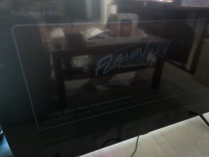

My Samsung un55tu7000 TV has an issue where sometimes when the TV turns on the image doesn't appear or is very faded (see image attached). Otherwise other times the image comes on and I can watch without any problems. Any idea what could be the issue?
Hi, I had the exact same problem. The version I have is un55tu7000fxza. When switching on from cold, a picture would either be dark, dim, or full brightness. Never knew what I was going to get. The lcd panel was fine, ie, I could see a picture if shining a flashlight into it. What I discovered is that by applying some gentle flexing to the tv, mainly towards the bottom, I could alter the brightness. Sometimes it took a fair bit of time to get the picture stable in terms of brightness. An obvious bad connection somewhere. Took the back off and gently flexed the main board with an insulated tool in various places. Wiggled the connections, especially the one that powers the backlight. All was good. Some gentle tapping on the metal backplate showed that the backlight was sensitive to this tapping. Time to take the lcd panel off. With the backlight led strips exposed, I wiggled each one of them, especially in the middle connection where two strips butts into each other. The strip closest to the bottom felt very loose. Took that set out and tried to make the pin/socket sit more snug. Couldn’t get that to work. So, I decided like any respectable hacker would do, I soldered a small wire bridge across each set of pins. Reassembled everything. All good! Yes, you would have got the same results with a new set of led strips.

Thank you for your response. The TV appears to have only one board (motherboard and power board in one). After taking off the back cover and trying to turn on the TV the image came on fine. Turned it off and on several times and it still came on fine. The issue happens randomly. This is a picture of the back of the TV with cover off https://imgur.com/a/KMDsP3I

Yes, you are correct it is the UN55TU7000FXZA. Yesterday I had the TV on for hours with the back cover on and the issue did not happen. This morning when the issue happened again I was moving the TV around and out of no where it started working again. So it makes me think it is a loose connection, right? I will leave the cover off and the TV on as recommended but I don't think it has to do with a heat issue based on the TV being on for hours yesterday with the cover on. When I moved the TV around today and the picture come on fine it did go back to having the same problem. Do you think it is likely a loose connection on the ribbon cable?

When (and if) the screen goes black, try shining a flashlight at an angle close to the screen and check if you can see images.
They will be very faint if they're there so trying in a darkened room may help to see them.
If they are visible then it's a backlight problem.

Thanks I will update if it happens again. Regarding the flashing the screen, when the issue happens I can still see the picture and images clearly but it it is dim (see original picture). And yes the red cable disappears into the screen.
