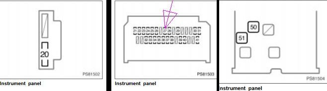

My cars 12-volt socket has not been working. I recently replaced the battery and thought that would fix the issue but it did not. I used a voltmeter to check to see if there was any current but there was not. Is there a fuse I should check or could it be the wiring itself? What are some possible solutions? Thank you in advance!
Hi @darmanskirata
Check fuse #27 in the instrument panel fuse box.
Looking at the owner manual there are 3 instrument panel fuse boxes but the one you want contains more fuses than the other two.
The manual doesn't specify the location only gives an image of each
(click on image)
I have the same problem, i have gotten the car to get "fixed" but the same problem is still there
@hffjgdybf Did you check the fuse? Is it good?
