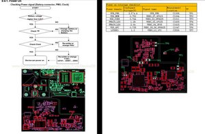

My tablet does not turn on
I dont know what happend
But it just vibrate every time i hold the start button and the screen light slightly for a second
hi @kareemramadan
Has the tablet been dropped or gotten wet at all?
Does the tablet charge OK?
Here are some images from the service manual showing the Power On troubleshooting flowchart that may help.
(click on image)
hello, I also got this problem. Is it worth changing a battery?
