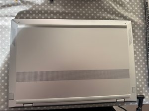

Replacement palmrest (front):

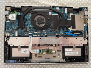

Rear of laptop with back cover removed (you can see the damaged hinge locations in the top right and top left):

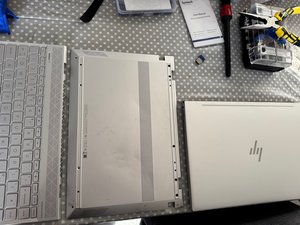

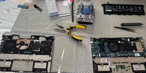

Transferring parts over between old and new:

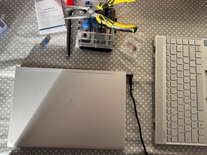

Job finished and reassembled:
