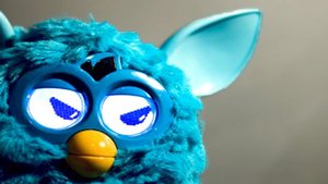

Hello, my furby is stuck in evil mode, when I pet it for a long time nothing happens and when I factory reset it it becomes evil again after a while

Some people call this personality the Grumpy and the Viking personality. Their eyes look like slanted half circles that have hard edges. Their logo is a Furby dressed up like a Viking. How to Obtain: Overfeed Furby, Shake Furby, Turn Furby Upside Down. Because of how easy it is to get this personality, Furby can stay in this personality for a long time.
To change the personality you can:
Play music to Furby, Sing for Furby, Use the app, Tilt furby from side to side, Pull its tail, Shake Furby, Tickle Furby, Rock Furby Slowly, Place another Furby beside it. There are 5 other personality's other than the evil one.
There is a Default Personality also called clown, that you can't change back into it normally. You must factory reset by flipping your Furby upside down, while simultaneously holding the tongue sensor and the tail. After the eyes shut off, they will be reset back to this personality. But be careful, repeated resets might possibly corrupt the configuration memory.
There is also a Personality Changer App on Google Play. It used to be free but now its around 1$
Here is the link: https://play.google.com/store/apps/detai...
Here is a video that may help: https://youtu.be/3NR2o9yrW80
Here is another video that may help: https://youtu.be/UteznTOUegE
You said that you have factory reset it before and it will become evil after a while. This leads me to believe that the Furby thinks it is being shaken, overfed or upside down.
-Make sure the tongue senor works, and is not jammed
-Lay the furby on a flat surface and see if it still reacts like it is being shaken, if it does the tilt sensor could be the problem.
I'm pretty sure the problem though is the orientation sensor. I knew someone with a similar problem. They opened him up, taking the front plate of the face. Then, found out that the sensor is a black box located on the left side of the furby. First, they tried to hit it a few times without any results. Then, they tried breaking into it by breaking part of the plastic box, and when it was broken, they turned him on, and now he works. I think it is a design flaw. The metallic ball was moving without any problem. To me it seems that the box is "too small" for the metallic ball itself... so it's always "closing" the circuit and every little movement is basically registered as a shake.

No I just asked if the test mode show if it was shaken I didn't do this. My furby turns again into evill mode after some time if I factory reset it etc. I checked the tongue and it is not jammed. Have put ti in flat surface and it just fall asleep somatimes the furby is acting weird like it can't breathe
@georgekts Ok so you had just asked if the test mode shows if it was shaken and you didn't do this. I understand that your furby turns again into evil mode after some time if I factory reset it, the question is why. Since the tongue is not jammed and when you put it on a flat surface it just falls asleep. Did you try to Play music to Furby, Tilt furby from side to side, Pull its tail, Tickle Furby, Rock Furby Slowly, Place another Furby beside it, and watch the 3 youtube videos that I linked?
Try to factory reset it again, lay it on a flat surface and time how long it takes before it goes back to evil mode. Notice if the furby thinks it is being shaken, overfed or upside down. I'm pretty sure the problem though is the orientation sensor.
I hope this helps, Thanks!
Hello thanks for the help! I lent my friends furby and mine became good I have noticed that before it turns evill it cries so I have read that furbies cry when they are overfeed and it asks for food once or twice a month and I never remove the batteries. I turned it upside down when it became evil to see if it reacts and it reacts
