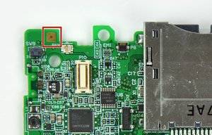

When removing a faulty power switch I accidentally ripped off the power switch with its solder pads still attached. Any available solutions to bypass the missing solder pads?
All right, I found a few posts on the subject and it appears the general consensus is that you only need pins 1 and 2 in order for your switch to work. Going by your photo, it looks to me like pin 1 is intact; that is, the solder pad is still present so you should be able to solder the switch onto that pad.
DS lite Power switch pinout : r/nds

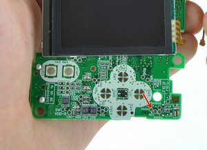

From what I found, one of the pins goes to a test point on the other side of the board labelled PWSW. The other is supposed to be a ground. Here's a picture of the PWSW point.
This post seems to be saying that PWSW goes to pin 1, and if that's the case, you should be good there, since the pad is intact. You can always use an ohmmeter to verify continuity between PWSW and pin 1 to be safe.
So now you have to find a ground pin to connect pin 2 to. According to that Reddit thread, there's a ground connection nearby.
I'd suggest using the gold square next to the power LEDs as ground since it's close by.
I think that's the square they're talking about; you can easily test it just by shorting pin 1 to that point with a piece of wire. If it works, run a jumper between there and pin 2 on the switch, solder down pin 1 and you should be good.

Seems to have fixed the issue. Thanks!
I accidently ripped pads 2, 3 and 4 off trying to remove the old power switch.
Soldered the new power switch to the main posts and pad one.
Soldered a wire to the leg for pad 2, and soldered it to the gold square next to the power LEDs
Was able to curve the wire around the post so the shell could solidly close.
Works perfectly.
THANK YOU!
