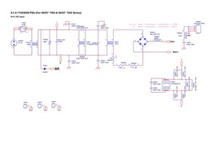

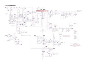

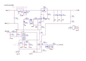

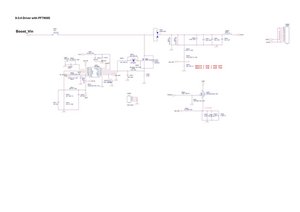

@uwn8r5maruubj3n we need a close up of your power board :-) Measure the voltage on R8619 you should get 43V DC on that.

@uwn8r5maruubj3n interesting! Anyhow, yes that makes sense that it first went partial dim and tehn it crumped all together. Anyhow, measure one more time but use both probes on the same connector. Red to + and Black to - Just to make sure. Each LED strip is rated for 12-24V and according to your measurement they would all be in parallel which is uncommon but not impossible I suppose. I would expect s higher voltage and some series-parallel connections. We'll see I suppose :-)
@oldturkey03 I get a 0 reading with that approach, not sure if expected or I'm doing something wrong? Initial readings were with black grounded in the chassis.
@uwn8r5maruubj3n If you measured it the same way as you did the first go around, you should get the voltages. Your power board should supply the positive and negative voltage needed for the backlight LED strips. Your meter was set right etc. Looks like it does not do that. Check the components around the connector and I see if I can find a schematic. Bad diodes or FET's are a possibility
