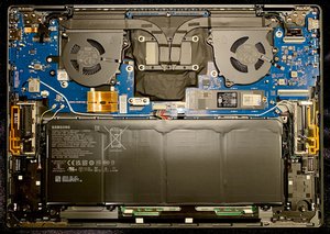

Does the 16" version come with an additional/extra second SSD slot?
I have the Galaxy Book 3 Pro 360 16" version that comes included with a 1TB primary SSD.
It has been frustrating not being able to find any information whatsoever online if this model comes with an additional /extra second SSD slot and I am hesitant to open it myself so hoping to find answers from the wonderful iFixit community.
The Galaxy book 3 pro 360 only has a SSD Slot. You can see it the picture. This is my galaxy book 3 pro 360.
Thank you very much for this teardown and asnwer. A couple of questions:
1) How difficult is it to open it up? I have heard the back cover is very hard to get off. Any tips?
2) After opening it up, do you think it could fit a SSD with a Heatsink or is it too thin for that?
2) Did you open it to upgrade the SSD? If so, which SSD did you use or recommend? I am thinking Samsung's 990 PRO 2TB but I fear there might be heat management issues
Again, appreciate you taking the time to do this and answering!
Hi, I answer your question:
It's not easy. You need a suction cup and a very fine plastic card. you must do it
you must do it at the bottom.
Sorry, not enough space for a heatsink.
3) Did you open it to upgrade the SSD? If so, which SSD did you use or recommend? I am thinking Samsung's 990 PRO 2TB but I fear there might be heat management issues.
I opened the computer to improve the ssd. Samsung 980 pro 2Tb. the 990 is better, but it is more expensive too but not much better. the 980 is very fast and I have not seen the temperature exceed 49ºC

Francisco, thank you very much for the helpfull post and picture.
How did you remove the piece of metal that covers the SSD?
