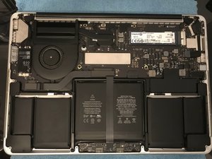

As @danj suggested, I decided to go ahead and replace the battery on my MacBook Pro, and while I was at it, I also removed the trackpad to inspect it. It was full of dust, some hair and other nasty stuff that had settled there over the years. I cleaned it off as best I could before reinstalling it to the computer. I suspect this accumulation of dirt is the culprit and I'll confirm in a few months if the issue doesn't reappear.
The cause of the problem was the accumulation of grime and debris underneath the trackpad after many years of use. I cleaned the perimeter of the trackpad with a cotton swab, some alcohol and compressed air, being particularly careful around the thin ribbon cables connecting the glass surface to the logic board. At the time of writing it's been 7 months since the cleaning and the problem is completely fixed.

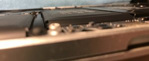

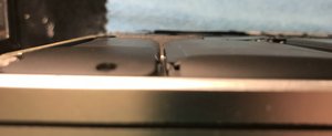

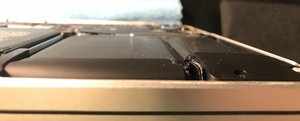

Take a pic of the battery before you pull it, let’s see how swollen it is. One of mine was pushing so hard the bottom cover screws pulled through.
Edited the question again to include photos of my battery (also took the opportunity to give my MacBook a much needed cleaning). Does it look too bad?
