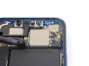

My Apple Pay has not worked at all. No card machine will recognise my device is there, it worked once since this happened, but not again.
An airtag type device used called 'squid' for tracking loyalty payments which also uses NFC (I assume) also would not recognise the phone. This makes me think there is a hardware issue with something, and not an Apple Pay problem. I deleted and put all my cards back on but the different pay terminals, and this squid tap loyalty thing still didn’t recognise my phone.
So, after seeing somethings about possibly loose NFC antenna plate, or something like that, does anyone have any insight?
Or links to a guide i might use to open up the back of the iPhone, locate the plate and NFC antenna, and check if there is anything out of place from a drop potentially?

Hello There.
The NFC antenna is part of The flashlight module. and needs to be "Grounded" to the frame with a screw.
Specifically it is the upmost metal piece/screw hole that needs to be screwed in (see image).
I just had a device myself with the same problem so i am a 100% sure.

Nice dude! Thanks so much for this. Any links on guides on how to take apart and fix this ? Or would you be able to let me know a little more thanks
@tomeaton https://www.youtube.com/watch?v=5fqpkHBX...
this is for the 13 Pro but the repair is "basically the same"
the order in which i remove parts is
1. Display
2. battery
3. Logicboard
4. earspeaker
5. Face-ID
6. check if it is screwed in properly.
Btw. I have almost never needed to replace the flex as it is usually a loose screw.

To correct things a bit, all wireless signaling requires an antenna of some sort. Distance and waveform dictate the size on what’s needed. NFC doesn’t need anything overly large and the product maker can do a good job hiding it too! The only limit is the housing needs to be radio transparent (at least a window). As an example the iMac logo on the back in the older systems is hiding a Bluetooth antenna! Here the camera area is the window.

después de volverme loco buscando la solución, he conseguido repararlo. El problema del NFC puede ser por varias causas, entre ellos daños en la placa base. En mi caso fue el problema mencionado arriba, el tornillo estaba algo suelto (puede que se deba a un golpe). Para arreglarlo desmonte la pantalla, no hace falta quitar los tornillos de la pantalla ni de la batería, puedes apretar el tornillo con la pantalla puesta. El tornillo en cuestión es arriba a la izquierda, creo que es el que esta en plano, no contra el borde del teléfono. En mi caso me vasto con soltar un poco el tornillo y apretarlo de nuevo. Este proceso lo hice varias veces con el móvil encendido y con la pantalla encendida en atajos/automatización/nfc/escanear. Con esto iba comprobando si leía una tarjeta NFC de mi ordenador hasta que conseguí que lo leyera. Es cuestión de ir probando lo fuerte que aprietes el tornillo.

For anyone else suffering: I had a similar issue, iPhone ignored all NFC. In my case removing the connector and reseating it fixed it. Didn't need to open up or replace anything. Harmless thing you can try before considering further repair.
Wthr- you are a lifesaver! I had the same problem. I read your comment, and realized that when I did a past screen replacement, there was a screw seat right in that NFC antenna spot that I had a problem with (the screw seat came out and was stuck to the screw with the shield plate sandwiched in between). After properly removing the screw seat and screwing it into the board properly, then replacing the plate and screwing it in solidly, the nfc started working! I had just about given up on it when I read your comment here thanks again bro!
When you say removing the connector, you refer to the one below the black plate covering that connector? we have to remove that plate to get access to the connector right?
Been a while but from memory, it's near the upper middle of the phone and battery connector. The plate actually puts pressure on the connector to ensure a good connection, because with vibration and impacts it comes loose. The problem with mine was that for some reason one of the holes in the board itself had been removed due to previous work on the phone, so the plate couldn't put pressure on the connector. It's a free thing to check, just reseat the connector and turn the phone on with the screen open and see if the earpiece speaker works (I just open YouTube and put my ear near it), that will indicate the connector / board is working so you can rule that out.
