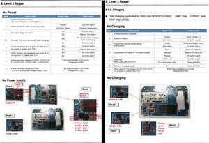

Hi @alex67421
As a supplement to @oldturkey03 good answer, here's the No Power/No charging troubleshooting flowcharts from the service manual for the phone that may also help.
(click on image)
