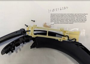

I got mine apart and found a white plastic piece broken at the flexing portion. Either need to find a replacement or use JB weld to strengthen it? Not sure. Was not too hard to come apart, trickiest part was removing the curved plastic piece nearest the earpiece from the flat plastic. Use small flat blade and get between flat and curved area moving the curved portion away out and away from the flat area. It has clickable locking tabs. I might update this if I get this thing glued...

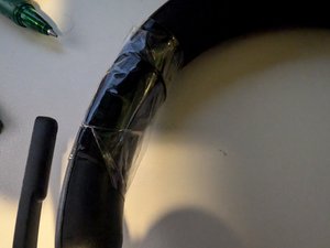

I have the same issues. I ended up using clear tape on mine. I just ordered the a new pair. The Evolve2 65 Flex. They must knew about the issue because they built it different this time.
