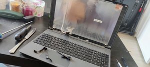

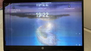

I can't seem to find the adhesive tapes to remove the LCD screen from the panel to put a new one. I have a HP 15s fq0071.
On the top it's not there and I don't see them at the bottom.
Please help

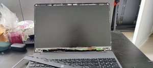

I was ready to give up when i finally found the adhesive tape hidden behind the hinges. (most videos says it sticks out bit this wasn't, neither at the top or the bottom but hidden). See pictures
With bleeding fingers and nails and tools stuck in between like dentistry I managed to grab it. And slowly pull it out.
Now I will look for the parts to replace it.
Thanks all who tried to help.
