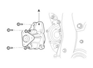

Remove the water pump (A) with the gasket.
  • Tightening torque :
  • 18.6 ~ 23.5 N.m (1.9 ~ 2.4 kgf.m, 13.7 ~ 17.4 lb-ft)

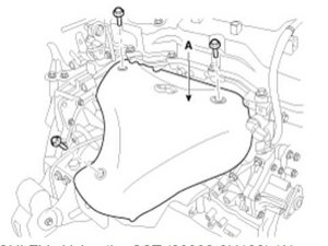

ULEV : Remove the exhaust manifold heat protector (A).
  • 7.8 ~ 11.8 N.m (0.8 ~ 1.2 kgf.m, 5.8 ~ 8.7 lb-ft)
SULEV : Using the SST (09392-2H100) (A), remove the front oxygen sensor (B) and the remove the exhaust manifold heat protector (C).
  • Tightening torque
  • Oxygen sensor:
  • 39.2~ 49.0 N.m (4.0 ~ 5.0 kgf.m, 28.9 ~ 36.2 lb-ft)
  • Heat protector bolts:

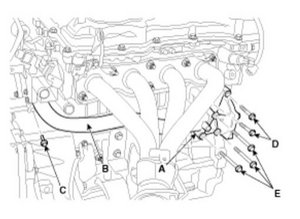

Remove the water pump housing (A) with the gasket and the water inlet pipe (B).
  • Bolt (C) : 9.8 ~ 11.8 N.m (1.0 ~ 1.2 kgf.m, 7.2 ~ 8.7 lb-ft)
  • Bolt (D, E) : 18.6 ~ 23.5 N.m (1.9 ~ 2.4 kgf.m, 13.7 ~ 17.4 lb-ft)
