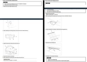

Here are some images showing the back view camera circuit, taken from the Hyundai Sonata 2010-2014 service manual that may help.
(click on images)
