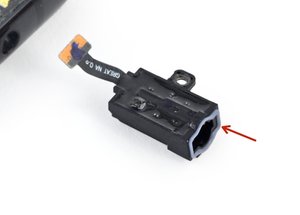

I'm having a little trouble with your picture, @almighty1, as it's not enlarging at all when I click on it, so my tired old eyes aren't having a lot of luck distinguishing the parts. Any chance we could get a bit higher resolution photo?
However, I do believe I've located one of them. From the teardown for your phone, it looks like the one on the right, the oval shaped one, goes on the headphone jack.

The piece you are talking about is actually for the Fingerprint sensor as I have found that part that is aftermarket at many places including Amazon and Ebay but even on iFixit:
Galaxy Note8 Fingerprint Sensor Adhesive
