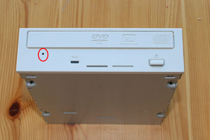

The DVD disc is stuff inside the DVD player. How do I open the lid to the player?
We'll have better luck giving you an accurate answer if you would include the model number of your DVD player, Stephen.
Without knowing what model you have, I can only offer general advice, so here you go.
First off, look for any small holes in the front of the DVD drive; it's common for those to be manual eject mechanisms that are activated by sticking a straightened paper clip into the hole. It will push the DVD tray out slightly, at which point you can grab it with your fingers and gently pull it completely open.

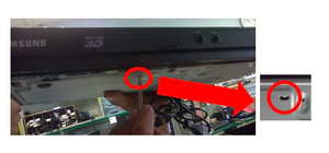

Apparently some Samsung players have an eject hole on the bottom of the chassis under the DVD player. It's actually more of a slot that you stick a small screwdriver in and move it within the slot.
Move it in the direction shown.
