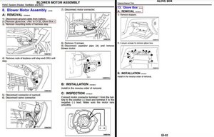

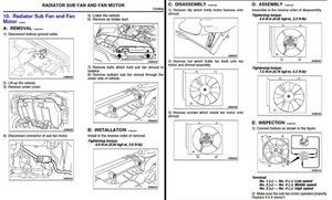

aircon fan starts then stops
aircon fan was noisey maybe bearing failure ?
Hi @grahamroby
Do you mean the AC blower fan or the AC radiator fan?
Here are images from the Subaru Legacy 2002 H6 service manual showing how to remove the blower fan and the radiator sub fan so that they can be checked.
