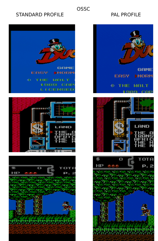

I have purchased NES from an online store and when I am playing games, it has some weird stairs effect, like every next line shifts with 1 pixel and then after 8, it goes back. On the letters/text it looks really bad. It is the same using Composite and NESRGB:

@oldturkey03. I am using a 15" portable monitor. I tried to connect another NES to it, and it did not have the problem.
NES that I have the problem with shows the same problem on this monitor, LED TV and capture card that I created the screenshots with.
I got another NES and tested Composite on it and figured out that NES with NESRGB in Composite mode and another NES with just Composite produce the same picture. So this confirmed that the CPU/PPU is working properly on the modded one.
I decided to research OSSC settings, even though SNES and SMD worked well with OSSC out of the box.
After some time, I found PAL profiles online (https://videogameperfection.com/forums/t...), and surprisingly ossc_profile_0.89_NESRGB.json fixed the sawtooth problem with NESRGB. Here on the screenshots I took, I show the standard profile on the left, and PAL profile on the right. I also changed the aspect ratio for PAL, so the screenshots look a bit different. But it is possible to see that both the lines and text are straight:

So, PAL profile fixed sawtooth problem. Now I need to figure out the yellow shadows and especially the flashing background on Blaster Master.
Getting PAL profiles for OSSC fixed the sawtooth/stairs problem. SNES and SMD worked without any issues on the standard OSSC profile but NESRGB needed a separate pal profile that I got from:

screenshot comparison Standard vs PAL profiles: https://i.postimg.cc/8zh6XCcw/NESRGB-OSS...
Now, I need to figure out the yellow shadows on Duck Tales and especially the flashing background on Blaster Master.
