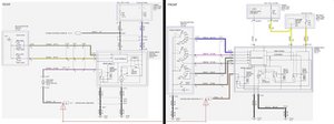

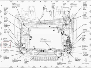

So i replaced my rear hatch when i disconnected the wiring harness from my old hatch to my new hatch on the passenger side i had a large wiring harness and a 2 wire harness coming from the car side but the new hatch only has the single large harness i plugged it in nothing is working now i have no front washer pump so i disconnected the harness and still no washer pump so whats the 2 wire harness for and what did i do original hatches 2010 the new hatch came from a 2008 please help

Here are some images of all the information contained in the wiring section of the 2008-2011 Ford Escape service manual pertaining to the front and rear washers.
The manual states that it is for model years 2008-2011 but obviously from what you're saying this is wrong.
I couldn't find anything on the 2010 model so hopefully this may help a bit.
(click on images)
