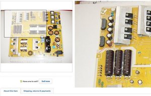

Disconnect the power to the TV and then remove the back cover from the TV and use your Tacklife MF tester in continuity mode and check that the fuse on the power board is OK.
Here's an image showing where it is located on the board.
(click on image)
If the fuse is OK then unfortunately since your tester cannot check for voltage values it is hard to know whether the problem is in the power board or the mainboard.

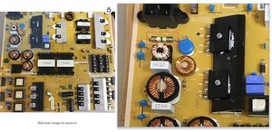

If you happen to know someone who has a DMM (digital multimeter) that you can borrow, you can use it to measure the standby voltage on the power board. This voltage is a signal voltage that is sent from the power board to the mainboard to indicate that power is available to the TV and it is the mainboard, upon receipt of this voltage signal that turns on the red standby power LED.
Here's an image that shows the standby voltage signal reference point on the board. In the standby state it should be 8V DC
(click on image)
Be safety aware when testing for the standby voltage as there is exposed lethal AC voltage on the power board
