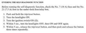

Why my oil indicator light not coming on when my ignition is on on(11)

Year 2004 and engine size is V6
Hi @drsholestal
Here's an image that shows how to enter the diagnostic test for the gauges and warning lights in the instrument cluster panel. This is just to check if the oil pressure warning light is OK or not.
(click on image)
To exit the diagnostic mode turn off the ignition key.
If the warning light is OK here's how to check if the engine's oil pressure switch is OK or not
With the engine off, remove the wire plug from the oil pressure switch and then check if there is an earth on the switch. (connect an Ohmmeter between the switch connector and the engine frame. It should measure 0.00 Ohms)
