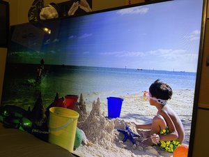

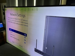

PowerON "No Signal" screensaver is scrolling ghost image rt side only
Upon poweron i get the banner at the bottom with all the TV program onboard options like youtube, netflix, etc... Once that leaves the No Signa. HDMI3 check cable etc... banner displays.. BUT the right side only appears with grey ghost image bar. I have video if need

Here is a video of the issue
The guy I got the TV from replaced the main board (component)… So I am thinking t-con or buffer
@flex4705 post some images or a short video with your question. Adding images to an existing question This could be a T-con or a main board issue. If you have already removed the back cover from your TV, post some pictures of your boards with your question as well.

I can get into the setup menu and I have not tried OTA signal. I do have the Tv connected to wifi… I will provide some images and videos. I can see some horizontal lines and some green hues …

Well @oldturkey03 and @jellybeanman i was setting up to test all the LEDs so removing screen and diffuser and once I got the frame off it turned out the screen has a fraction of a chip on the corner which severed part of electronic communication ribbon embedded in the glass. I then noticed paint on the frame of the corner where the chip was discovered. The movers must have banged this Tv pretty hard on the sheet rock or something to chip the corner glass of the screen.
I will say the guys at shop jimmy said it’s likely a problem with the screen itself and too costly to repair. So yep it’s garbage…
Thanks
@flex4705 sorry to hear that the damage is that severe. Thanks for coming back and letting us know what the outcome was. Discard of the LCD properly and sell the boards on ebay. At least you may recover a few $$.
