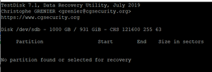

Testdisk tool :
TestDisk 7.1, Data Recovery Utility, July 2019
Christophe GRENIER <grenier@cgsecurity.org>
https://www.cgsecurity.org
Disk /dev/sdb - 1000 GB / 931 GiB - WD Elements 1048
CHS 121600 255 63 - sector size=512
[ Analyse  ] Analyse current partition structure and search for lost partitions
>[ Advanced ] Filesystem Utils
[ Geometry ] Change disk geometry
[ Options  ] Modify options
[ Quit     ] Return to disk selection
  • I Can identify the drive. (this is probably the rom/bios informations of the pcb)
  • Unable to identify / read the partition table. (this is written on the disk)
  • The analyse process didn't give anything good :-(
