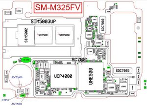

phone vibration samsung m32
when i put the phone on vibrate it doesnt vibrate at all nothing

If the vibrate motor doesn't work, below are some images showing the Motor troubleshooting flowchart and the location of the components mentioned in the flowchart from the Galaxy M32 service manual.
Here's a guide that shows how to remove the vibrate motor
(click on images)
Has the phone been opened at all?
