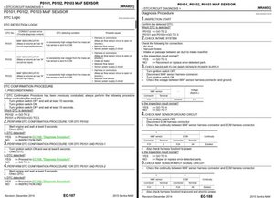

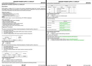

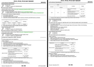

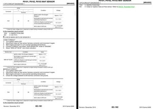

Hi,
I realize that you have replaced the MAF sensor but perhaps the problem is with the MAF sensor circuit.
Here are images from the relevant section of the service manual for your model that describe how and what to test when there are MAF sensor DTC codes.
(click on images)
Note: Ref EC-447 mentioned in image #2 is shown in image #4.
Hopefully this is of some help.
