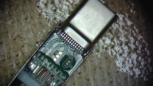

I found that the "correct" USB jack to solder onto the little board on the end of the PSVR2 is made by JAE Electronics and the part number is DX07P024AJ1. You can find these on Mouser or other electronics supplier sites. It has a slightly different pin spacing than some of the generic jacks you can buy on ebay or similar.
DX07P024AJ1 appears to be just one of the models they used, I've had a few on my desk with different models as well. Sony didn't appear to really standardize the PSVR2 cables that much. Shame no one seems to be able to figure out what the other end is, though I suspect it has some integrated electronics to help split off the audio so it's probably proprietary.

So it appears DX07P024AJ1 isn't a perfect fit, but it's about as close as we're going to get. The pin spacing is perfect but the shell is only keyed on one side and only half as deep as the original, the other side isn't keyed at all. So the shell requires a bit of modification to fit, but it does work.
Seems these boards that require the DX07P024AJ1 have 14 pads per side, normal usb-c only has 12 pads per side. The additional 2 pad are for shielding. They fit 14 pad in the same space as 12 leading to a bunch of misalignment issues if using normal usb-c replacement parts.

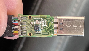

Sony doesn't seem to wish to address the issue of replacement parts and appears to prefer charging people ~$500 USD to replace their headset with a refurbished one instead, so you're kind of on your own to fix the one you have as it is proprietary. Luckily the end that tends to break most often is just a standard USB-C 24 pin (12 pins per side). So you can, if you're skilled in the dark arts of soldering, replace the tip. It's super tiny work, and really no fun, but it's either that or fork over more money to Sony to fix an issue they shouldn't have in the first place, it's not exactly difficult to reinforce a usb connector.
The cable looks like this on the inside of the headset, so nope, not standard usb-c in there. That little white JST connector is for the "motor" controls according to Sony's teardown video.
Finding a straight-up replacement tip isn't always easy, so I tend to prefer just buying bulk usb tips that come attached to a PCB board then desolder and reconnect them where I need them.
A repaired cable should end up like this if done correctly, then you can just shrink wrap it or 3D print a new body, preferably one with more protection than the original that actually supports the cable and prevents repeat breakage.
All of this requires some skills and is not for the feint of heart as those usb-c pins are roughly 4x the width of a human hair.

While I have used an assortment of those very same connectors, I just had another one come across my desk using a non-standard pin spacing, so it's not one size fits all sadly. Justin McIver pointed out earlier that he had found another connector "DX07P024AJ1" from JAE Electronics which works with these weirdly spaces models.
Sony appears to have just used whatever was cheap, different factories, or probably both.
