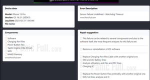

This is my friends iphone 13 pro they got it the first day of retail itself.
according to my friend "i switched off my phone in the night and from the next day onwards it started lagging being unresponsive and crashing all within a minute"
I have experienced the bug it and it seems like the screen freezes and eventually the phone heats up and boots.
The phone was on IOS 16.2, i couldnt update it through the settings as the phone was repeatedly booting up while trying to install, tried to install IOS 16.3.1 with a mac, still didnt work. I eventually flashed it using 3U tools "retain user data" and the bug still continues on the iPhone. I have gone to an authorised repair centre and the person there told me that " i can try one thing which will remove all user data but thers a risk that your phone might get stuck in a endless bootloop " and said we have to pay out of our pockets for a replacement as the phones out of warranty.
what do i do now
{"bug_type":"210","timestamp":"2023-02-21 13:43:46.00 +0530","os_version":"iPhone OS 16.3.1 (20D67)","roots_installed":0,"incident_id":"734BCECE-BCBA-47D8-BCB3-7E0A196452AF"}

try replacing the charge port with a genuine replacement
I'd also like to add a couple more things they could try as well. Try a new power flex and volume flex. Those can typically cause the device to reboot every few minutes. Make sure they're OEM. Since the X and above these devices have been picky about charge ports and typically only accept OEM.
Follow this guide. It'll give you a better idea as far as what is causing the issue. https://www.youtube.com/watch?v=QaJLYbtu...
Thanks for this, my panic string is as follows (latest panic string)
"panicString" : "panic(cpu 1 caller 0xfffffff0251b2118): userspace watchdog timeout: no successful checkins from SpringBoard in 180 seconds\nSpringBoard has not exited since first loaded\nservice: backboardd, total successful checkins in 1137 seconds: 101, last successful checkin: 110 seconds ago\nservice: SpringBoard, total successful checkins in 1110 seconds: 93, last successful checkin: 180 seconds ago\nservice:
I dont think its the flex cable, but im very new to this and would like to know
