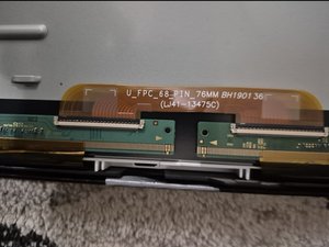

I changed power supply and main logic still getting power cycle. So I slowly started to plug stuff in and out. What I found is the power cycle gets tripped on and off when I plug the flex cables into the buffer board. However right before it starts to cycle on and off I can briefly see a picture with lines through it before turning on and off cycle. Is this the flex cables or buffer board?
@joev1987 not sure what you refer to as the buffer board. How does it power cycle? What exactly happens? When you do see the picture, describe what those lines look like. Thin? Thick? Horizontal? Vertical?
@joev1987 my suspicion is that you are referring to the LCD driver boards. Yes, those are the ones that are the prime suspect for this.

Anthony Emanon just to recap. Same TV 75” Samsung Q60 QLED TV qn75q60rafxza? Which wires? Are you referring to the ribbon cables that connect to your LCD panel? If so then the restart is most likely related to the panel. there are a couple of boards that connect directly to the LCD panel. Those are not removable and are your LCD driver boards. It sounds like something on there is shorting out. For now, I would not buy any boards but see if you can troubleshoot some more. We would need to see pictures of what you have going on there. Adding images to an existing question

I think the problem is here but got no idea how to fix have to tape of some pins on the flex cable

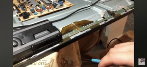

@oldturkey03 No picture on screen and red blinking light and tv turns off and on tried tape on some of the pins on one flex cable and screen stays on but no picture probably panel itself is no good but will keep trying
@dawn82925 post some pictures of your main board and your power board. Try to disable the error detect if you can. How many times does the power LED blink?
