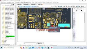

Hi there, I got a iPad Air 4 wi-fi (A2316) , iPad came to me with a charging issue. I replaced the charge port. It didn't work out. It only draws 0.15 amps still.
There happened another problem while I was trying to get the protection shield out on the motherboard. I desoldered some small capacitors and resistor near to the LCD fpc connector. I soldered them back but because the info was not clear on the ZXW , I soldered them wrong. Then I tried to test the screen but screen didn't work. I searched youtobe to be able to see those components' exact position on the board, then I realized I did a mistake. I measured the fpc legs on diode mode. All data lines shows OL. I know I messed up something but I don't have any schematics, ZXW drawings, working board, nothing.. I don't know what to do. How should I proceed?

I would post some pictures of what you're looking at since it seems like correcting the screen FPC will need to be step on. XinZhiZao does have a boardview with labelled lines for this, but no diode mode measurements and no schematic. But some photos will get us started.
Hello there friends, I will try to add some pictures of the fpc connector’s components. Also will check XinZhiZao software if I can do.
https://postimg.cc/grD5rkXZ
you can see attached photo of lcd fpc
number 1 is where I messed up, i desoldered those components by mistake and I resoldered them vertically not the way it seems now. Then I tried to test the screen. after I understood I messed up, I tried to find a clear view of the board and managed to solder them correctly (lost one resistor though).
number 2 and 3 are the problem right now. most of the upper fpc connector legs show OL, these 2-3 are the image filter or coil I assume. But I dont have any chance to replace them.

I use ZXW and Wuxinji board views and schematics... but this model does not have diode readings or enough information to recover the information you need. My best suggestion at this point is to find a icloud locked donor board on ebay... or join FB groups for microsoldering and board repairs to see if you can find someone with this board to measure for you (I don't have that model or I would). But even if you did find the information, you lost a part... with a donor board, you could just transfer those parts and even take your own DM measurements ahead of time. as for the charging issue... Charging port is usually the guilty culprit, but if already replaced and you are certain the port is good and repair good, I'd move on to the Battery connector and take readings and then on to Power Supply IC

I have managed to get back with visual, after I soldered the those components I burnt one of them by shorting. I replaced the components there from the donor board (also a question here, is there a place that I can buy small components on ios mitherboards like resistors, capa etc?)
Now about that tristar or charging IC , I am adding a picture shows a charging IC on air 4 board. It show same chip as ipad pros and some ather models. The chip model clearly visible you can search for it. Normally it doesnt show as air 4 part. I am confused, should I go over and start replacing from it?
https://ibb.co/Cmw9p0L
@kellivin I use mobile Sentrix for most components. here is a link to that Charging IC ... https://www.mobilesentrix.com/charging-i...
If you have repaired the other missing /damaged components using a donor board, battery and charging port are okay, then yes, I would try this IC next.
