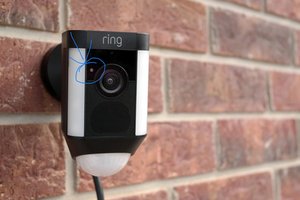

Where is the microphone located
Where is the microphone located on a ring spotlight camera
Hello Anthony the location of the microphone is shown in the image below, if you are planning to tear it down it would be in your bottom right corner assuming you opened the camera from the back. Hope this helps!

I have wind noise from my Ring Spotlight camera's, so I am going to try to cover the microphone with Ursa short fur circles to try to eliminate to noise . Will report back when completed.
Hello,
I originally tried Ursa short fur circles to try to eliminate to noise from my but this was not successful.
Secondly I tried TOYMIS 10pcs Microphone Wind Filters from Amazon - https://amzn.eu/d/81JDXxE
These have had limited success. I can now increase my volume up to 30 % without getting the annoying wind noise from my Ring Spotlight camera'
