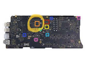

@devnol - I think the best thing here is to find a local Mac expert. It’s clearly a logic board issue within SMC and how it meters the battery’s charge. There are a pair of resistors which are used within the voltage comparator logic a liquid spill often drips right where the SMC chip is (see image in my answer below) that’s the only thing that makes sense.

So either the support components or the SMC chip (Texas Instruments/Stellaris LM4FS1EHSMC controller) it’s self may need replacing.
